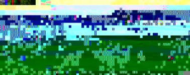

for sake of time, here is what mine looks like, i found it online.except this guy removed his rudder and mounted it to the nozzle.

Last Mohican said:
Cool.  It's just kinda hard to see in that diagram how the trim works.  I thought maybe an actual picture would help me understand.
Here are a couple I found on google to give you an idea in the meantime....

Looks like the two Kenny posted are different from each other.  The bottom looks like what I have seen with a label on the control that says "Jet-O-Vator".  The top one looks different  I still don't see how it trims.  I see it on the pics Orange posted.  Its that third cable on the very bottom that hooks right to the reverse outlet.  Interesting stuff.  Would that still be a "Jet-O-Vator" or was it called something else?
SimplyOrange
the top one devilman posted is the same as the ones i posted and the same that i have, it also uses the same jetovator electric worm drive inside of the boat.to understans how it works you would have to have it in your hand and tae it apart, thats how i learned about it.
the piece that says "berkeley" swivels side to side on the bowl, te piece that has the reverse cup on it mounts to the piece that says "berkeley" so everything moves side to side off of the bowl.
i know mine is the latest design before the most current one that they sell now.
